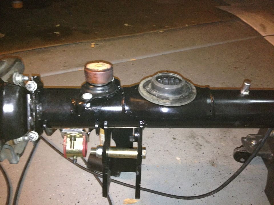

With rear springs the bottom coil needs to be clocked appropriately. General rule of thumb is the end of the bottom coil should be facing down the centerline of the differential towards the driver side. If they are not this way, it can/will cause a ride height issue.
I've never clocked my rear springs. Changed them a few times. How can there be a height difference from which way your springs are facing? I mean the perches don't have a relief to set it a certain way.

Like Jeff said…Rule of thumb is the pigtail points inside, but I am not sure if this is the OP issue?
It's a valid question. I do not have a specific answer for you. I have always been suggested to do that.

Well shit, now I'm going to be looking every time I under there to see which way my little pigtails are pointed. Thanks!
They line up in the rubber grommet on the perch. IIRC the writing on the spring will face out.
Both springs, tail pointed that way?

Highly doubt the direction of the coil is going to matter much with the stock seat, not to mention nearly an inch of difference is a lot. If you're sure you're adjusting the panhard right (loaded) then yeah, try swapping the springs around. That won't show a total reversal even if it is the spring, but can rule it out. If you still have the stock springs, you can throw those in on both sides and see if the problem still exists.

It is actually a proven fact that they should e facing a specific direction. Even Eibachs directions talk about spring orientation. I personally have experienced this issue myself.
