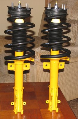

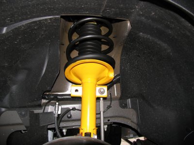

I got yer Koni/Eibach combo right here! :beer: Actually that's my set up!:rock: Jayman set me up with these. They are the adjustable type. They do the job for me and I recommend them to you or anybody.
