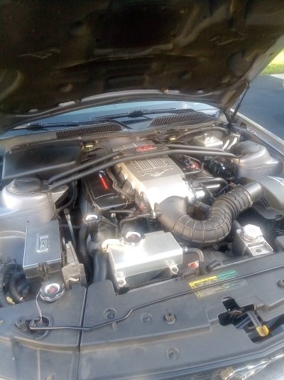

I spliced a Jegs air/oil separator in the OEM tubing.
As far as coolant tank covers, I went with CF..
Unless I am crazy is this a 5.0 this doesnt look like a 3v... But the covers look amazing I will look into those and also do you have any idea what that color is called on your valve covers and suppercharger that is the coolest look on these cars TBH...

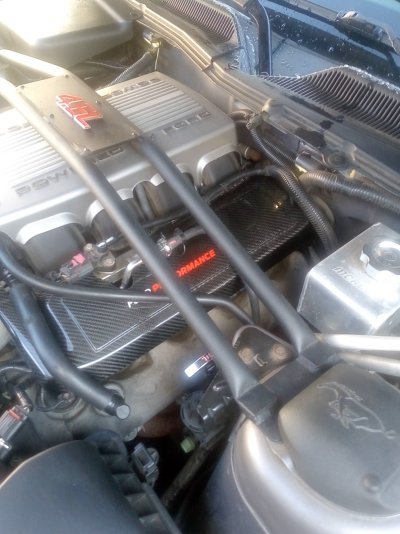

I rewrapped my loom when I had the engine out last year, the loom was tired and shabby looking but thankfully working ok. It only seemed to be factory wrapped with insulating tape and plastic conduit that had got brittle and fell off in places. I wrapped it with cloth tape and added new conduit on rub points. The early S197 looms on anything with higher mileage are getting brittle now.

It's a 5.8, 2014 GT500.
The tank covers were made by Trufiber.
Whipple & most powder coaters refer to the color as " Ford textured blue " or " Ford blue "..

I did a partial wire tuck on my car. I dont think there's any pre-built extension harnesses available for this. Cut, extend as necessary, solder, heat shrink and wrap in fresh cloth tape and split loom tubing. It's not for the impatient.
Two things made a pretty big visual impact for the time invested.
First, heat wrapping the big bundle that runs over the passenger side cam cover and tucking it down along the frame rail. Not sure if your passenger side turbo will allow that though.
Second, moving the injector and coil wiring under the intake manifold and feeding the individual connectors between the runners.
Unfortunately, I don't currently have access to any existing photos or my car to take new ones.
Nicely bent stainless hard lines with stepless clamps at any necessary rubber fittings on the PCV system would also be a nice improvement over the random hoses, fittings and worm drive clamps. Again, it's gonna be custom work though.

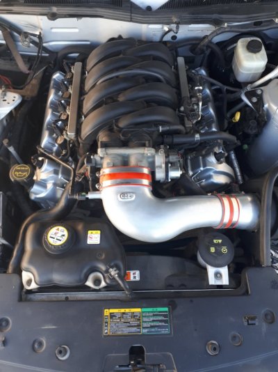

After I put my Whipple in I decided I did not like the clutter of the bay either. I ended up relocating wires and hoses to try and give it a cleaner look. this is what I ended up with.
I didn't relocate any major components, Just wires and hoses. Went with an aeromotive fuel rail set up without a crossover, and re-reouted hoses and wires off the top of the engine as best I could. Having breathers got rid of a couple of hoses also. I also replumbed my intercooler lines basically reversing the flow but the hoses don't crossover any more than they have too.
A couple of the in progress pics.

Wow dude this looks amazing I am definitely still gonna run a catch can but yours look very clean! How many of the wires did you have to splice you think??? How challenging on a scale from 1-10 do you think it was and how long did it take you???
