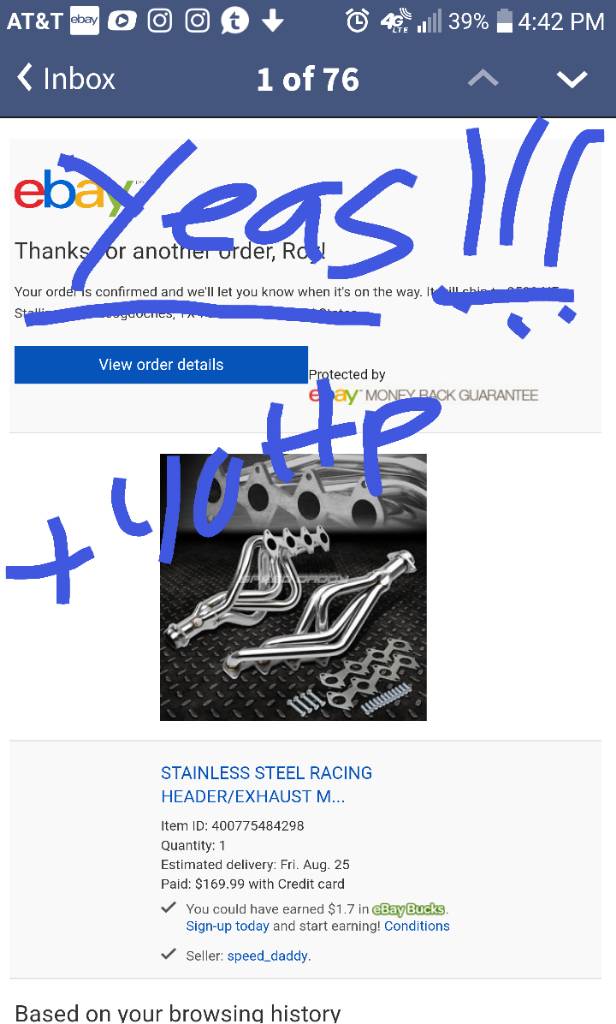

Those are another design, like a full length header.
I read somewhere the "pypes" made the most hp over th average and peak. So I went with that copy from that particular eBay vendor. (speed_daddy)
