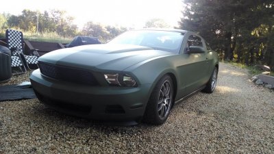

Some notes on the process.
I've had the BAMA tuner a while now. It sucked at first, then I called to complain/return it, and ended up on the phone with an excellent tech who sent me his personal tune he uses on his personal car. Love it, and the car is a lot louder. I don't really like loud cars, I'll keep the OEM exhaust forever, but I do enjoy the little extra rumble from the tune.
I haven't adjusted the eibachs yet, but damping seems balanced. The springs could be a bit stiffer, and of course they'll sell me just about any spring rate, but I'm happy for now. The spindles modded are great. The steering is about as fast as an S2000.
I do get rubbing now, because of the spindles. I have the giant custom spacers waiting for when my 3d printer arrives to make myself some flares. I could've gotten custom offset wheels, but I prefer spacers, they are cheaper than wheels and I can always take them out. Steering angle goes from 45 to 65 degrees. Drift time!
The carbon clutch pack diff, only $240 at American Muscle, is as good as anything. I hated the stock 2.9x gears in my v6, until I got 275/35/18s which are some 1.5 inches smaller in diameter. Now its faster than stock.
I'm running 8.5 degrees caster due to the smaller tire size, to give me back some mechanical trail. The increased scrub radius has basically zero self-centering properties. Toe is 0,0 and camber is -2-2.
The front is as low as it gets, and the rear could be an inch lower, though I'd probably want to reroute the ebrake cables, as they go under the sus. arms, and that's weird/close. I clear speed bumps, if I go the speed limit. The air dam under the bumper will scrape lightly on some of the longer shaped speed bumps.
Brakes are perfect, now that they have bolts in the calipers.
Vinyl is awesome, it will go on every car I ever own ever again. Never seems to get dirty, and I had someone open their door hard into mine, with no visible damage.
The next mods are bolting on the LED fog lights and vents in the hood.
At some point, if the engine seems still healthy, I'll do a stage 2 clutch, flywheel, and driveshaft.
A supercharger may arrive if I feel like wasting 5k on power adders, which I probably never will... I live in the mountains, so 300hp is already too much. On some of the narrowest, crappiest paved roads you've never seen, you could probably easily tap 100 in a 25, not that I've tried. It does take the local jumps better though; smooth landings.

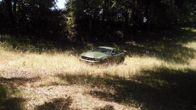

I also added a pic of me in the 4th Miata I owned, and rolled, plus a pick of the mustang grazing in its natural habitat, because why not?
