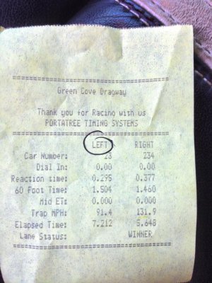

This was my last run of the day against a crazy Ninja (note, I was more focused with test and tune than competition all day)
I managed a 1.50 60 ft which was my best of the day but they were mostly hovering around the 1.5-1.65 range for the day.

Attached is my final time slip of the day too. I know I have much MUCH to learn, but am very eager to do so.
