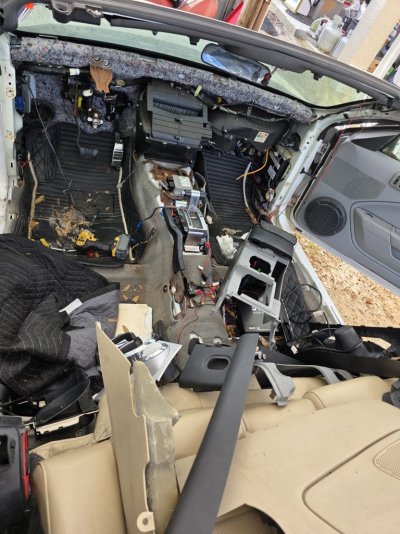

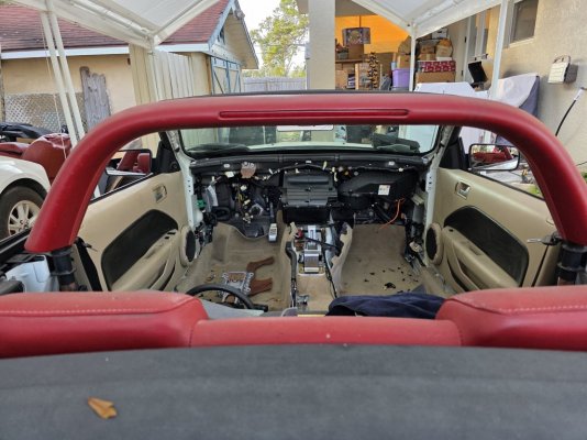

Both cars are apart right now, so I can't test them. When they are back together, I will connect Forscan with a variety of cable to see what works. Oh, also it seems to me that using a different PC or version may have made a difference
