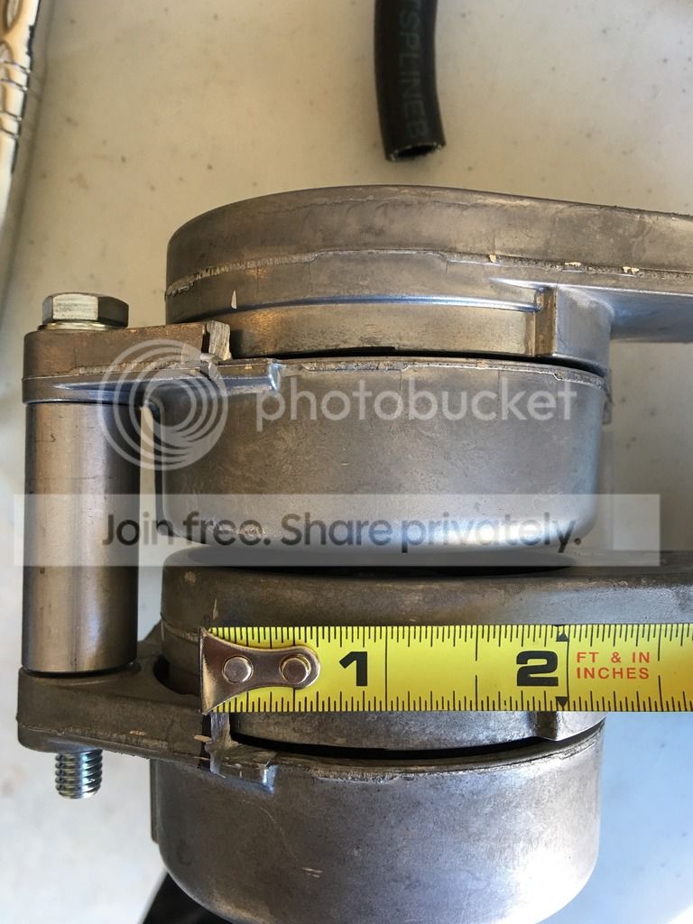

How exactly do I measure the 2 inches of travel needed. I am looking at the pulley in the recessed area of the timing cover moving. Eyeballing it, it looks like 2 inches of travel to me but could use more insight. Thanks.

I'm not quite sure what you are asking. I mean you have more than two inches of travel there. Why would that change? It should have the same travel as the stocker seeing how it is two of them put together.

You cut the stops off with a Frankentensioner which allows it to travel more.
I really can't tell if that's all she's got. Do you have any pics of where you cut the stops? If the stops are cut correctly it will travel enough.

Why don't they just come cut to the correct size?
Because I would have to charge them the time/labor to do it which would drive the cost up considerably. It's not hard to do and it saves the customer money.
