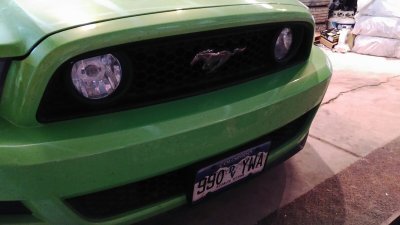

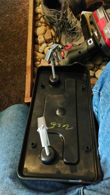

Thanks for the reply. I'm a disabled vet (nothing too serious), but am a Citrix consultant, working as a contractor at Schriever. I did 12 years active duty and 3 years in the ready reserve (USAF). Some days I miss it.... most days I don't. :)
Fortunately, no holes were drilled in the bumper. I'm not sure if this is how the bracket is supposed to go, but it seemed to fit very nicely this way, and snugged down very tight with the drywall brackets. It won't budge unless you really pull on it.

Excellent idea! I did not understand why you would use drywall anchors but it's because they go behind the lower grill and hold the plate (holder) in place. Clever lad!
Well, your solution is a more cost effective than my suggested no-drill-bracket guy. The pic will help out a lot of Mustang owners who don't want to mar the bumper with holes! Thanks for posting up the pictures.

I was pretty proud of myself when I thought about it. I still don't know how it's *supposed* to go. Do people really drill holes in their bumpers for a license plate? That's heartbreaking...
Hopefully it helps someone!

I'm still surprised it was an idea. It's been holding up great. I thought about putting loc-tite on it, but I don't think there's a need.
