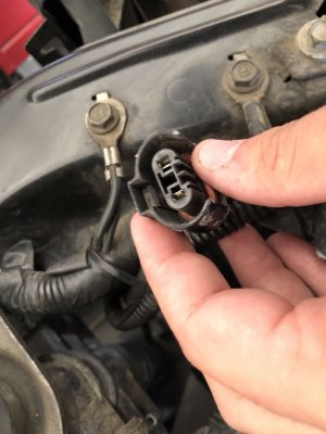

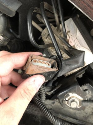

Hey everyone, I have an 05 gt that doesn’t have the front turn signal assembly and I’m trying to see if the car still has the wiring harness already. Would anyone know if any of these wires are for that assembly? (If not, do they look familiar for anything else)
Any help is appreciated, I’m trying to avoid ordering a set of turn signal assemblies and then having to order wiring harnesses

I think those are right for the turn signal assemblies. There are also cornering / parking lamps in there so two plugs per side. I'll see if I can dig up the photos of my OEM wiring harness before I swapped to HID. Those plugged directly into the turn signal assemblies.
Just a warning, when you buy a turn signal housing you wont get the socket the bulb goes into which also has the Male plugs for the harness on them.
But to answer your question those ends look correct and aren't hacked off, and there are no 'jumper' wires extending down the the turn signal assemblies so those should plug into the sockets when you get em.

Thank you so much sir! I’ll have to do some searching for assemblies w/ sockets
If anyone is selling some hmu!
