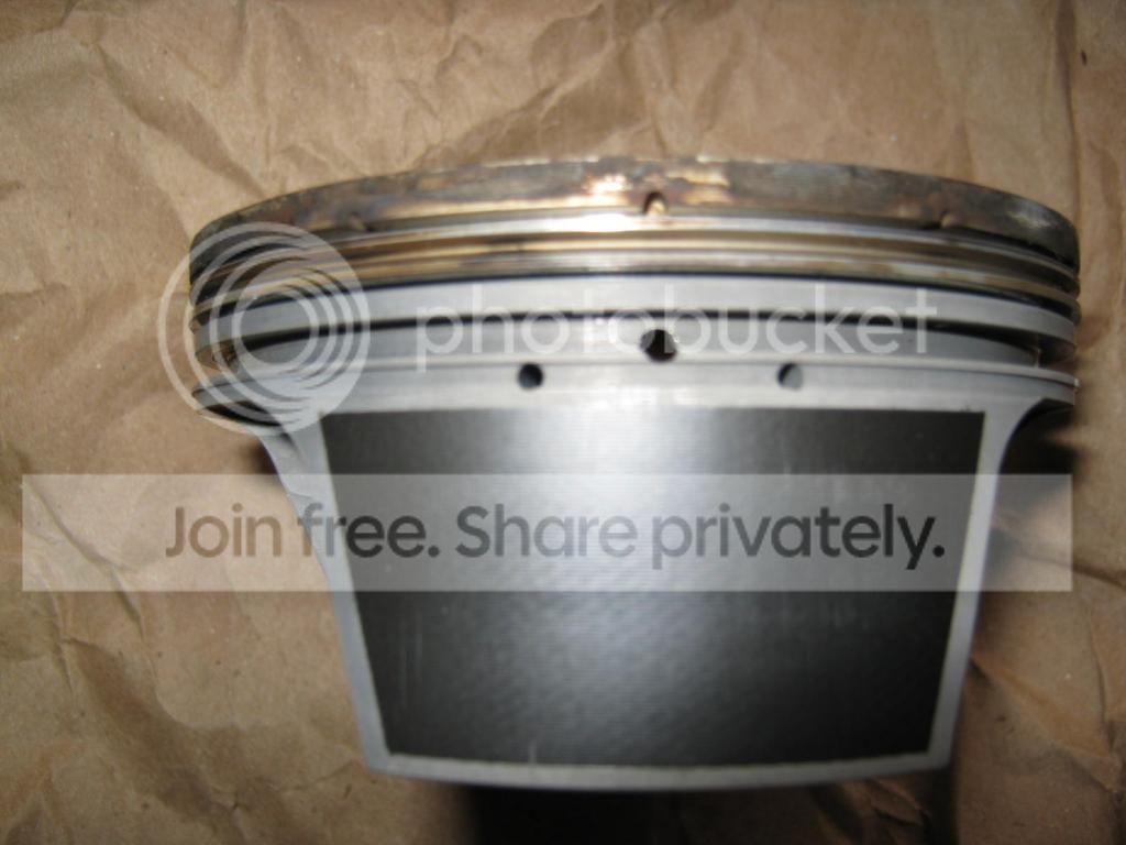

Piston manufacturers do this. I'll see if I can dig up some pics.
Edit: I only found one set with the top ring ported. They all have the oil rings ported.
It's a Mahle that was built to Yates specs for the FR500C. Nice piston with a 3.705" bore requirement.

Thanks Bruce,that's pretty much what they showed, ever build a 3v with these? Pros/cons?

I have them. Race application, 16:1 compression, 8200 rpm. Total Seal ring set.
Diamondpistons1.jpg~original
Diamondpistons3.jpg~original
