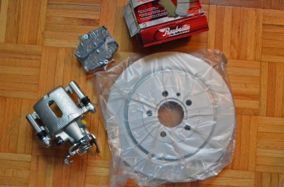

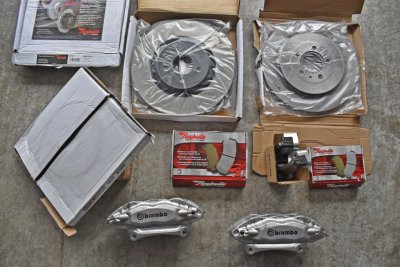

Two types of brackets available. The Ford made ones all one piece so you must remove the axles. Then the Aluminum "add on" brackets where you don't touch the axles. Because my Mustang only gets a few 1000 miles a year of use, the back calipers froze from sitting. So for years, I was just using the front calipers. After a few test drives in new Camaro V8s including a ZL-1, I decided up redo the Mustang brakes with a big brake kit. Most of the money is in the front. The back brakes are rather cheap at Rockauto. So everything was done as a matter of course. After several bleeds, everything is new and the brakes are wonderful.

As I said, you will not notice that much in the rear even if the rear calipers were missing. Mine were frozen. The race only 13.8 inch rotors are very cheap. I got mine at RockAuto for $15 each. They have no RUST protection and will rust bad at the first wash. I replaced them with the same but with rust protection for $35 each.
Possibly silly question but you do know that the rear caliper pistons have to be screwed back in, right?
I've heard of people trying to push the pistons back in and having a hard time. Of course, that being because there's special tools needed to twist them back in.
