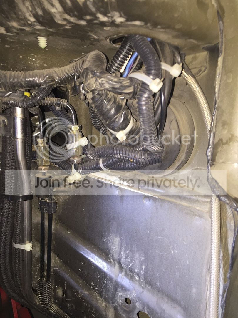

Guys, now that the car is producing boost I want to properly run the guage pod with the boost gauge and air temp.
The issue is I have run a coat hanger through every gromet under the hood and the hanger gets caught up in the fire hall every time.
Where did you all run your wires and boost tubing through??? I am worried I pinch it
Any help is appreciated. Yes you may laugh at me...Rebuilt the motor, installed a blower and cant fun lines without fear :whistle1:
:helpme::helpme::helpme::helpme:

Remove drivers tire
Remove plastic innear rear fender well.
Locate enormous rubber grommet that has the engine wire loom going thru it.
Cut a hole in said grommet and feed your wires where you need them to go.

One of those grommets has what looks like a nipple on it. Cut off the tip of the nipple, run the wires through and then use a zip tie to tighten everything back up.

Those nipples are jammed full
Air lines, wires for compressor, my WOT box, etc
I need more nipples

Hah. What all you got going through it
JUSTA3V
Moar Throttle!
Jul 25, 2015
704
Queen Creek AZ
Wideband
Oil pressure
Nitrous pressure
Fuel pressure
Water meth display
Some grounds as well.
