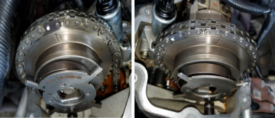

On to timing and this is where I'm a bit lost. I'm using the FRPP hot rod cam installation instructions as a guide. The cam phaser bolts are loose and when I put the crank timing mark at 7:00 no timing marks are visible on the phasers, even after rotating the crank another turn or two. If I crank it to where the right bank R is visible around 11:00 and on the colored link, the left bank is also showing R but not lined up on the colored link and the crank mark is at 1:00. Same happens on the left bank when I crank it to get the L on the left bank on the colored link at 12:00, the right also shows L and the crank is again at 1:00. It appears that my timing is WAY off. Am I looking at this correctly? Also, plugs are out and belt is off and the effort to turn the crank changes quite a bit through a rotation. I'm interpreting all of this as something is really f'ed. I'm also at a loss as to why since other than removing the valve covers to paint, no part of the SC install messed with timing. Thoughts?

Sorry I wasn't clear. I loosened the phaser bolts following the steps of the cam installation procedure. I know they are one-time use, but I don't think you can count on the position of the timing marks unless they are loose. I think my next move it to remove the timing cover and look.

Well, I had a guy come over that's built these before and we walked through everything. I've got a bunch of pics. The timing was off by a lot, before I messed with the phaser bolts which was a bonehead move now that I have a better understanding of things. Anyway, time to start pulling things apart and see what went wrong.

It's likely you have bent valves on the cylinders with low compression. You'll know as soon as you get the heads off. If you can get a scope would be worth your time scoping them first. Suggest asking your friend who knows these engines to help diagnose. All in all this is likely a few grand to fix it right.
