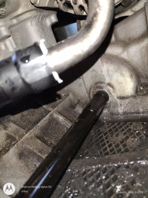

Hi folks,
So over the last few weeks I have been smelling coolant faintly. Expansion tank looses fluid no visible leaks no milky cap no water on dip stick no running issues no over heating. So today I got a loaner pressure test kit. Pumped it to 15 psi I look all around then I see coolant between oil pan and trans.. middle of the car. So only thing I can think of is that hose that runs under the intake . Then slowly drips out when driving is why I only smell it faintly at stops etc. Anyone else have this issue

It's is most likely the coolant pipe under the intake manifold. Get a light and look down between the intake manifold runners at your engine block valley. Is is stained with coolant? There is a weep hole in the back of the valley where it will drip into the exact spot you described above.
The coolant pipe connections under the intake manifold are o-ring sealed and the o-rings wear out.
Some people including myself cut and sectioned the pipe and joined everything together with heater hose and worm clamps. Did mine a few years ago. Hasn't leaked since.

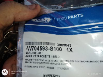

Ford's is and that's the one I would use
Ford # 7r3z-18b402
Dorman is like 626-626
The difference in price is 18 bucks and the dorman one looked cheaper

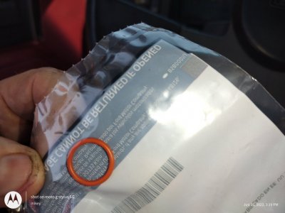

Don't forget these little suckers ( need 2) & rather take the time replace em now than do this all over again ..lol nobody had em had to make a trip back to Ford
See pic
