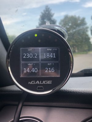

First off, thank you for tuning in.
So I have been dealing with this problem for a year now, and my car has been to 6 different shops now. No results. Please give me your opinions and advice.
The problem I am having is that my gauges are showing my Cylinder Head Temperature at 230° F. I start the car, drive for a bit and the temperature eventually reaches 230. Usually within a few minutes regardless of city or highway. Just a little back ground on the car, I have a Mishimoto Aluminum Performance Radiator, 180 Black Magic Xtreme fan, and a 180° Thermostat. Now, I got here because when I first got the car I started noticing the gauges looked higher & after comparing them to a friend with a similar set up they were. So I took the car to a shop & they told me I needed a larger radiator to help compensate for the heat down here on the coast. So I got the radiator, the shop went to install it & ran into a problem when the stock fan wouldn’t be able to fit in combination. The shop gave me a call and told me I needed these 2 mini fans with no shroud to make the fit. I agreed because of my ignorance & wanting to fix this issue. I picked the car up & on the way home I noticed that the CHT was about 5° lower than before. The shop had mentioned that it was running perfectly fine so I was annoyed when I had seen the gauges. Now here I am a year later still dealing with this problem, running in a circle with multiple shops telling me to replace the same things. I have done everything they asked & yet the problem persists. I have no coolant in the oil, I don’t have any water leaking from the exhaust, the upper radiator hose is not swollen. I am completely beat at this point. I have used a thermal laser gun on different parts of the engine. If anyone needs them I can post them if it helps. I’ll go ahead and say that the Upper radiator hose is at 160-170°F at operating & lower is 95-100°F. Any additional information needed, I will absolutely try my best to post.

I don't even know what my CHTs are. But I can tell you there are many safeties built into the PCM, and if it was an issue you would have at minimum, a check engine light. 213F coolant and 230 CHT sounds about right. Yes, it is a bit on the high side, but it is summer time.
Do you have any pending faults? (no idea if the Nguage can read pendings)
If the car is tuned, and they disabled some temp protection, than that is another story.

I have no faults &a never had a check engine light. I have just always seen most people stay around 200°-210°

Cylinder head temperatures seem to run 20-30°F above your coolant temperature. The sensor is in the aluminum, not the water jacket so since the coolant is there to pull the heat from the engine, the CHT has to be higher than the coolant. The computer starts to deactivate cylinders at 265° F so you are still well within the engine's happy place.
Very good point, I hadn’t thought about that myself.
