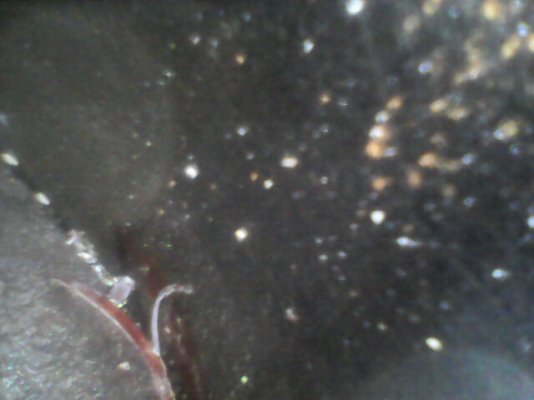

Speaking of... I got curious as what carbon buildup in the engine looked like and put an endoscope down into one of the cylinders and I don't think I liked what I found.... Anyone have any ideas what that the silver bits could be? Is my engine a time bomb?
What would you do to further diagnose?

Looks like one of those fancy headliners! LOL
Actually kind of hard to see what that is showing. I know sometimes close up pics show stuff that you wouldn't normally see. That one part that looks peeled up is interesting.

Is that the cylinder wall? If so it looks like dirt fell in when the spark plugs were pulled and stuck to the cylinder wall.

If they all look like that you should be good to go. Clean them up with a brush and some cleaner and check the gaps but they don't look bad at all. I'm glad you pulled them to check on them. That's the best way of avoiding issues when it does con=me time to replace them be sure you put a bit of anti-seize on the barrels (not the threads) and you should be good to go. Also, next time, try some compressed air into the spark plug barrels before removing them. This will prevent so much debris in the cylinders.

Thanks - yea I took my shop vac and blew everything off with the back end of it, but I think I'm learning the car was stored outside for some time. There was a bunch of debris that had gone in past the coil boots
