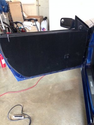

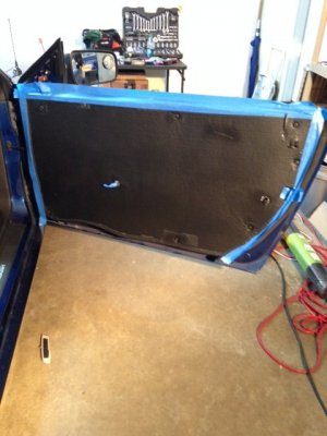

Jus thought Id share some door panels I made to replace the stock ones. I DD and race this car and I care about how it looks on the inside. So, I thought Id replace the door panels and save about 35#s at the same time. I used extreme light weight insulation panels from Lowes and some thin carpet material I picked up at Advance Auto. Finished panels weighed less than 2#s each. I did the same for the rear seat delete. Knocked off another 28ish #s back there as well. Total materials came in at about $40

Damn u took it to a extreme but looks good.
Thanks! I am king of biting off more than I can chew sometimes. But this was pretty easy if you have headliner glue and a heat gun. The bare doors looked terrible so had to do something. If I had your horsepower I wouldn't care about weight...:waytogo:

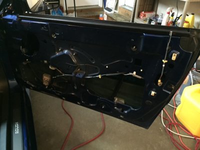

How do you open the door and operate the windows from the inside?
Its controlled from the driver side for the windows and have a small hole that the cable barely sticks through that you pull to open the door.
