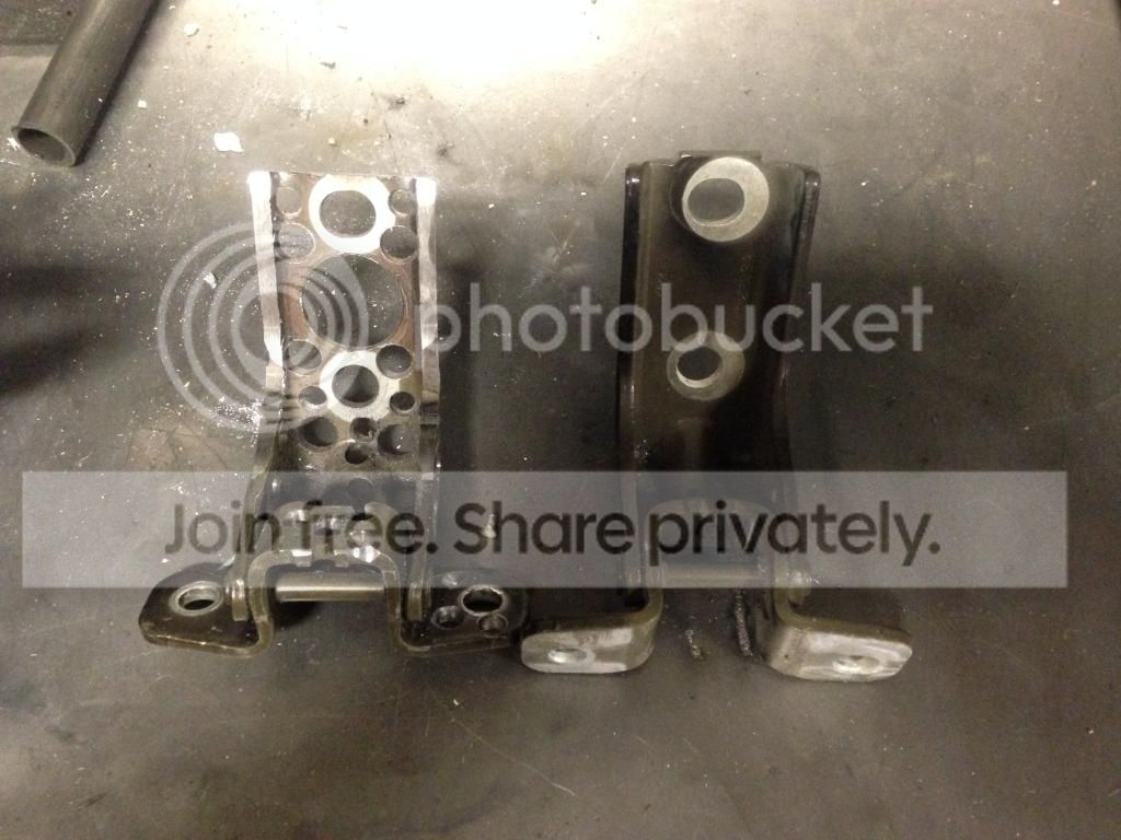

I went extreme and even lightened the hinges
Very nice . thinking on going to carbon fibre doors and wanted to see if it was worth the weight savings as I was going to re instal the power windows . Tru carbon has started making a stck style & outlaw style door . Thanks for the info . I watch your build all the time . Amazing !:rock:
