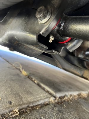

I installed the BMR front lower control arms..but now I am unable to access the grease fitting. Anybody have this issue or a solution? I even bought the 90 degree angle to try to access it, however it would not fit. Please help :)IMG_7870.jpg

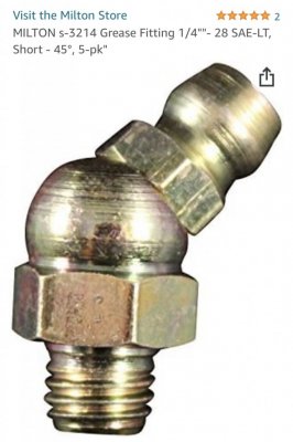

F89BE01F-527F-4796-B9B0-5987A99830F9.jpeg Remove straight grease fittings and install 45° or 90° fittings. Then you will be able to get a grease gun on them.

yea, your going to have to take that fitting out and get a 45° or a 90° grease zerk fitting to access it.
Might get lucky at an Ace hardware or a Napa and they'll have them in stock. Pretty common item.

I had the exact same problem. IIRC I used the 45 but I still had to use a burr and carefully enlarge the hole just a bit and it worked fine.

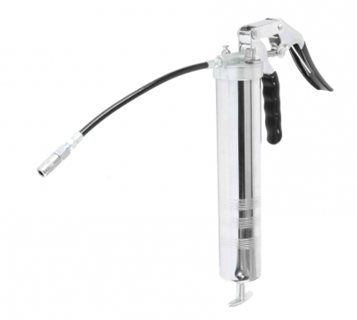

The grease isn't going into the fittings and squirts around the fittings. I bought the grease gun from Jegs (see image below)
I got one of these pneumatic ones a while back and never looked back. It's super duper handy and now that I screwed on the 90* slide on nozzle I just use it for all of the fittings.
