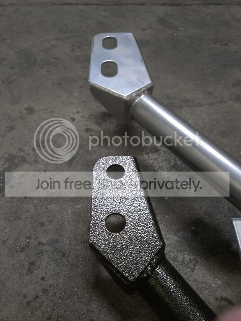

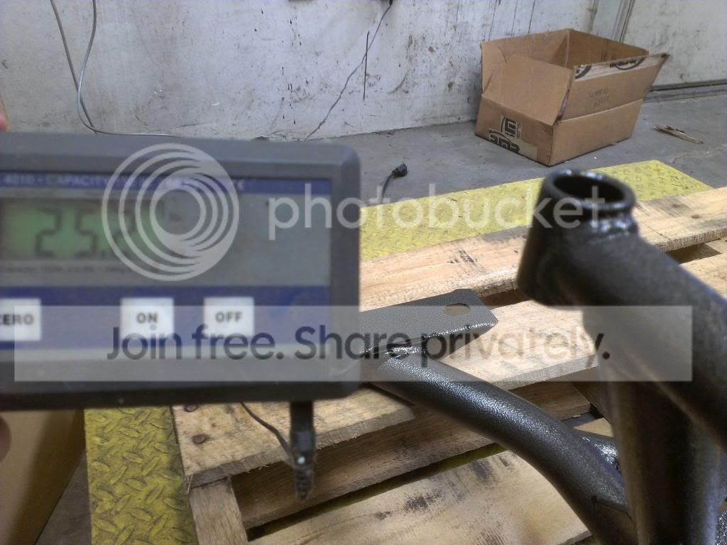

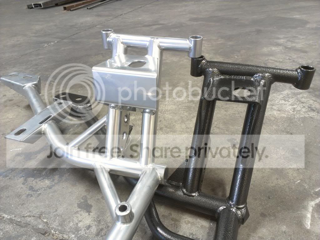

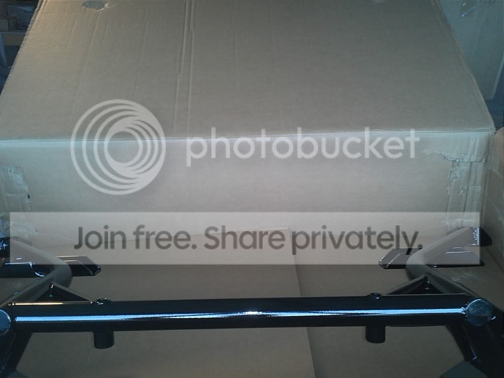

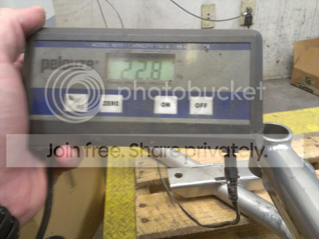

So, a local shop who was struggling with their installation of a UPR K-Member on a 2011+ GT, came today to pick up the BMR 2011+ K-Member (KM018)
Of course - I had to take the time to do a little comparing. Unfortunately, I was not able to compare to our original design, that they copied, due to it being at our other facility - but I was able to compare the current version on the shelf, to the UPR piece.
Looks to me like a 2.4lb weight savings. We will call it 2.5. The UPR has a gusset removed, from the installer trying to make clearance for a Turbo Kit (Hellion) As you will see, that was part of our redesign (replace the large tube gusset with a triangle plate)
Anyhow, here are some pics I snapped. Enjoy.

I was actually looking to post this to show that the weight difference is very minimal, as well as point out some of the differences.
I wish I would have been able to compare the UPR version to our older version that they replicated. O-Well.
I found it interesting how they chose to provide clearance for the EPAS rack. We re-engineered the entire K-Member, they just whacked some material out of the front tube. lol

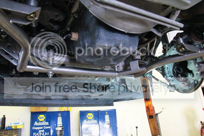

Google NEVER, ever ever ever lets me down.

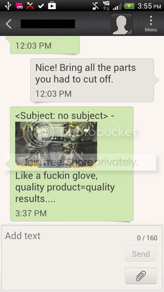

I am not sure if Sharad would know?
If you read above, the customer brought their UPR K-Member to BMR, to compare....then buy a BMR piece. This was due to the EPAS issue of the UPR.
I compared them. He bought ours.
Then he sent me:
I have had no less than (5) people / shops mention EPAS issues with their UPR K-Member. I may not be the horses mouth, but since I know more about their part than they do, I know that there is NO WAY to retain the factory EPAS location, without raising the rack...or "hacking" the K.
What is interesting, indeed, is that yours fit....yet the hacked their K-Member for no apparent reason. Awesome!

I do find it funny how the guy in the pic I found, doesnt even have EPAS, but has the hacked bar. hmmm
