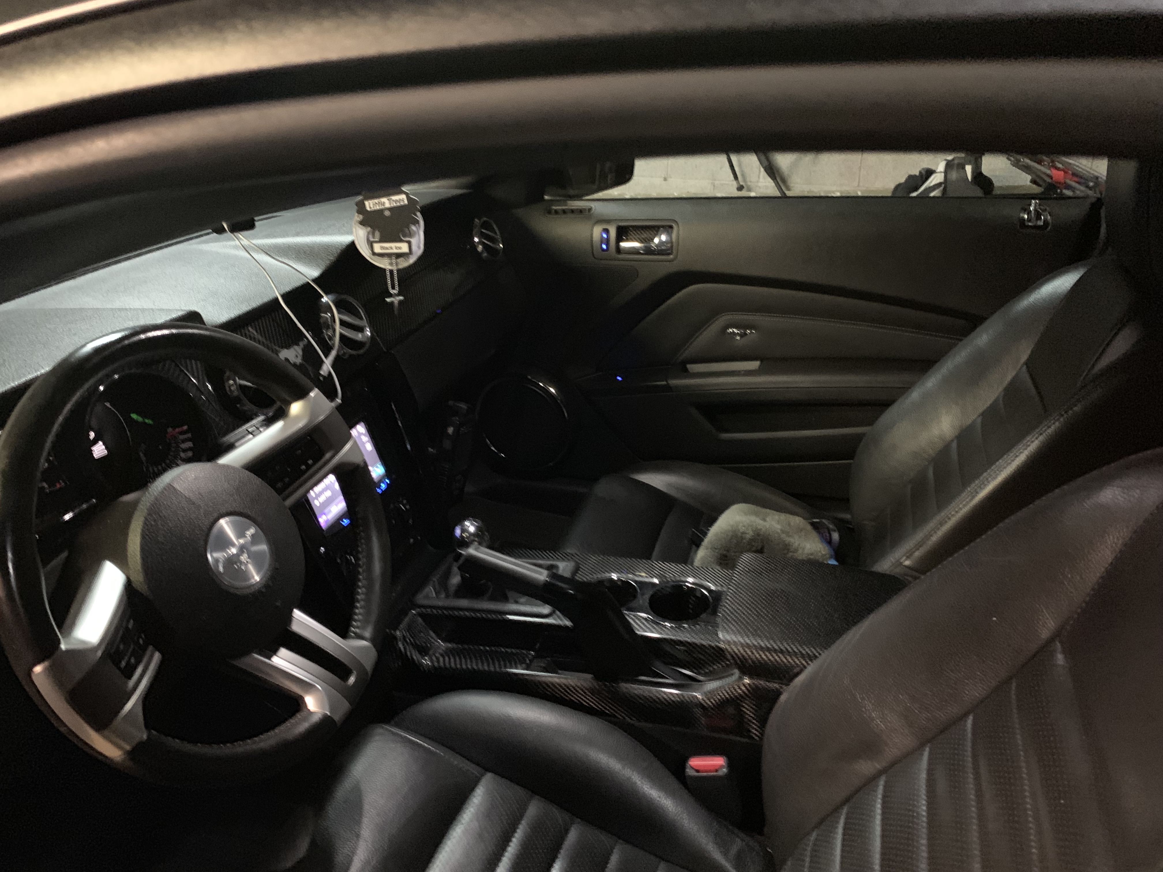

Totally off subject... But do the 2010/2011+ steering wheel buttons work with 2005 - 2009 cars somehow?

Yes sir. Wiring is not hard to do. You need two wpt-440s (harnesses thay plug into the clock spring) and a pac swi rc module. Let me find the thread for you...hang on
teeje
Mar 7, 2017
563
102
Ohio
Here's the link. It is not hard to do at all. Just pay attention to the instructions
2010+ door panels work just fine too with some modification.
These are from a 2014 gtcs
https://mustangforums.com/forum/200...and-have-fully-functional-audio-controls.html
