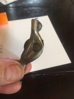

I had both intake rollers fail on the #3 cylinder, within a year of each other. Not hard to replace, or expensive ($10/ea). Remove valve cover and turn motor to valve's lowest point and *carefully* pop off roller with screwdriver, then pop new one on. Be careful with cam lobe. If you have the same issue, it's visually obvious (on cam) when you remove the valve cover. See photos attached and this link to a youtube video for the sound mine was making.
