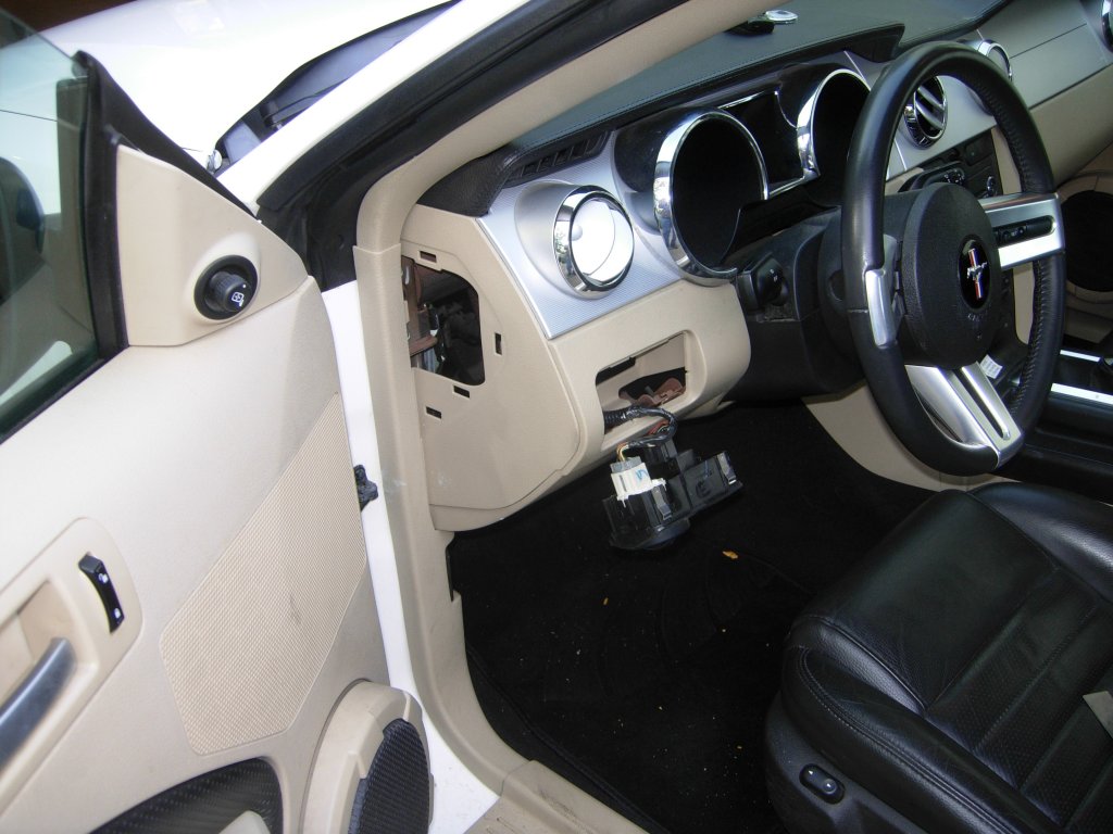

Just installed a new headlight switch

Maybe I turned the switch counterclockwise before turning off the fog lights too much? I had to replace the switch because the fog lights were turning themselves on without me pulling on the switch.
I believe Ford's part # is 11654. This was the easiest fix I've ever worked on any car. It took me nine minutes from start to verifying operation. The switch cost $38.99
Gently pry open the trim panel on the left side of the dash with a small, standard screwdriver. Push gently on the back of the headlamp switch, and it will move out 1/8". Push gently on the back of the interior dimmer, and it should come out enough to pull it out all the way. The connectors are the standard squeeze and pull type. Installation is just connecting the plugs, pushing in the switch, and snapping the panel into place.

BottleRocket - the thing I noticed about my switch was that the fog/driving light switch was loose and wouldn't stay off. I guess you could say it rattled a little. If it feels floppy, you may want to replace it when you get a chance.
