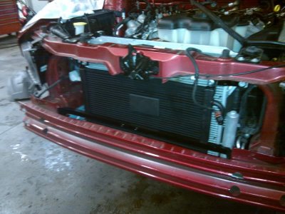

I've also looked at the 2010 install and it doesn't help, can't even see where theyv put it on. Horrible instructions on the 2010 intercooler install

I just found this pic as I woke up and was eating breakfast before I headed out there to try to figure it out.
I'm not sure if it will help me, or help you help me yet because it's on a 2010 but here it is.
You can kind of see how its supposed to mount on the 2010. If I mount the top to the impact bar it will hang way to low I think
