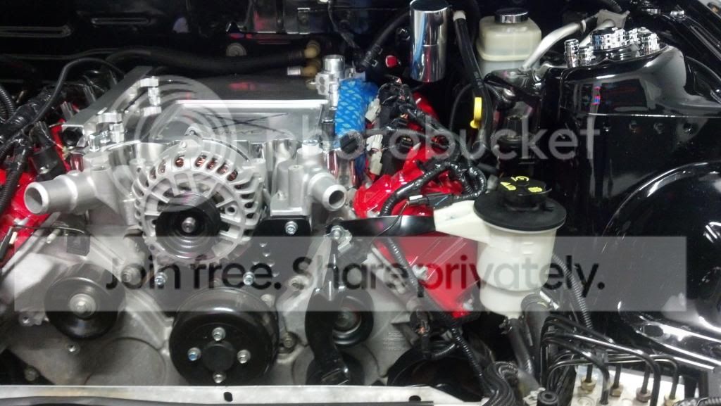

Bye-bye M90. Enjoyed you on my stock 4.6. But now it's time to give this big 326 stroker what she deserves.
Winter project is officially underway. Don't really have a timeline. But the 2.8L liquid cooled Mammoth and other mods I hope to keep me busy through the cold winter until I drive it again in mid March. The throttle body is a beast compared to stock lol.

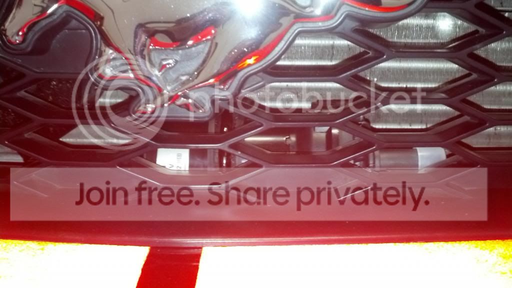

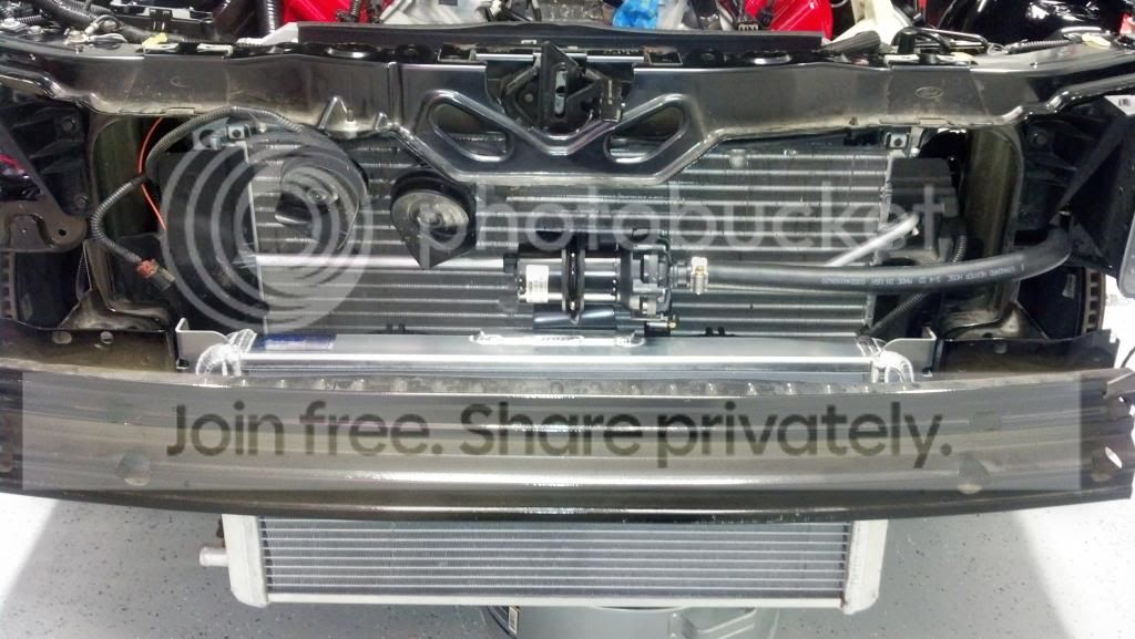

Got the Afco twin fan mounted. Also made a custom bracket here at the shop so I could mount my intercooler pump on the Afco like the GT500s are set up. Since the GT and GT500 grilles/fascias are different, a little trimming to the back of the grill was necessary and it fits perfect.
Tim ...
Nice going and it looks A-OK !!!

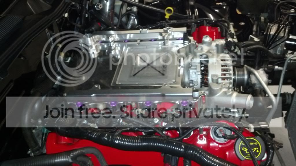

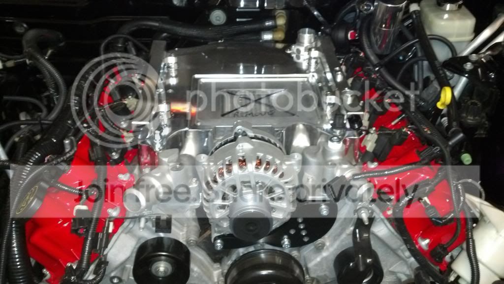

Got some work done yesterday. Intake, ID1000 injectors and Fore rails. I have a little custom work to do on the driver rail because of the tight fit back by the bypass valve. Almost done with that. Since the tuners I've talked to want the regulator after the rails I'm having the rear side of the driver rail drilled and a -8An male fitting welded on. Unfortunately you cannot have a fitting at the end of the driver rail because of the bypass valve. It will exit the side of the rail between # 7 and 8 injector. Also I'm waiting on a special socket to remove the alternator clutch hub from the alternator and that will just about complete the install of the 8 rib pulley kit.

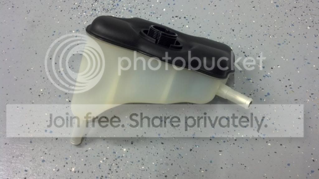

I'm going to be installing a large Roush 96 oz intercooler tank next to the engine coolant recovery tank which meant relocating the power steering reservoir. Made the custom bracket yesterday.
