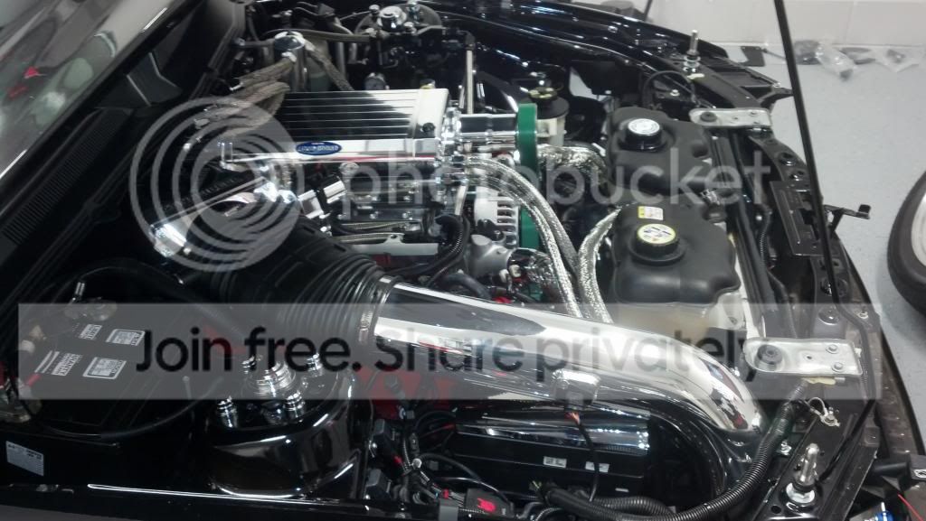

Hello Tim,
That is really honestly Awesome looking under the hood.
Man you sure do excellent work :highfive:

Thanks guys. And full frontal? I'm not sure we know each other that well yet lol.

Looks very good..

That thing is going to rip...In for results!
I hope so! Anything is better than the M90 I had on it, especially since I'm now forged and stroked. I'm probably going to keep it at 15 psi and keep the HP around 600 until fall when I can put a Magnum XL 6 speed and McLeod dual disc in it. Then I will turn it up some more. Right now I've gotta make due with my stock 3650 5 spd and the Exedy Mach 500 clutch. I can't afford to tear that up just yet. Gotta wait towards the end of this year when I've got some cash.

nice job indeed! And good choice in the fore innovations. Their quality always impresses me. The vac manifold is a god send.
You can also install a hobbs switch on that vac manifold to control the second fuel pump. I had problems with fuel temp before I ran one. They are cheap and mine turns the second pump on at 3psi boost.
Thanks. Yes I have a Hobbs switch from Fore that turns on the second pump at 2 psi of boost. I agree that Justin makes products worthy of art and the customer service is top notch!

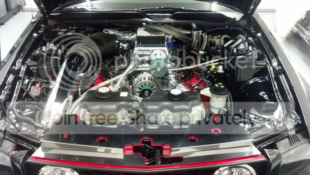

Sure did Bruce. Tomorrow afternoon is the official first fire up! And ok Mike....here is a "frontal" for ya. I just hope all goes well tomorrow. I'm sure I'm in good hands with Jon Lund.

Is there any reason you are waiting to start it?
You have probably already thought this out but I'm going to go over it anyway. Turn the key on and visibly check for fuel leaks around the injectors prior to proceeding. Sometimes they will leak and need adjustment or an o ring. You don't want to be loading a tune with a leaky injector. Also, turn the key on for a few seconds prior to the first start up after loading a new tune. I'm not sure what the deal is but motors don't like to start on the first key on after a tune unless a few seconds have gone by.

What size motor and compression ratio are u running?
Well my family takes priority over all else so today is really the best day to do it. I finally have a day all to myself. I still have to fill up with coolant and fill the intercooler, put the inner fenders and front tires on, put the car on the ground and fire it up. I checked the fuel system for leaks several times an we are good to go.
Sent from my EVO using Tapatalk
Brenspeed B326 stroker 9:8:1 compression
Nice work Tim! Looks amazing with all that bling!
Thanks!
