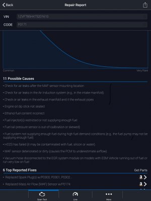

No luck so far with the fuel additive nor have I been able to find a vac leak. I attached a photo of my scan report going to try cleaning MAF sensor next. Any other ideas out there let me know.

Probably isn't the MAF because that would trigger both banks since its the air inlet. Triple check those PCV valves for cracked fittings / any air leaks
