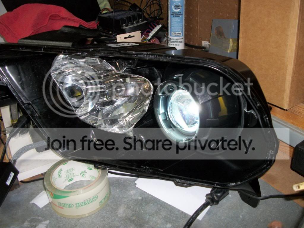

I converted a set of 2010/2012 Headlights with the Moromoto D2S Mini projector, running 5K bulbs, 35w ballast. I have been running this set up for over two years with no issues and the light output is amazing. I am now building a second set with the newer 3.0 version of the Mini D2S projectors and going with a 6k bulb at 50 watts. I bought a new set of lights from ebay since the aftermarket fixtures are easier to open. I am also modifying the CS Foglights since they are a projector as well to accept an HID bulb, going with a 3k for a yellow output.
Pics of the original build:

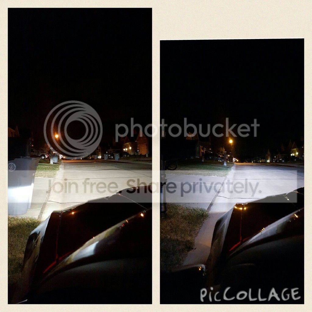

I just purchased some LEDs at a local supply shop. So far the headlights are awesome! They are V16 Turbo LEDs, paid $65. 3600 lumens, 6K color. The high beams are great. You can hear the cooling fans run at power up but so far I'm very pleased. As far as the fog lights they came from the same place but a cheaper $35 plug and play, no power supply. 6K color but not very bright.
HIDlightsusa, in Ga. Owner has been very helpful.
My son purchased LEDs from LMR as a kit. The headlights are not very bright on either setting. The fog lights are a different story. His fogs are more like brights. He is running halo headlights and fogs from AM. Those have a small dome over the bulbs where my factory housings do not.
