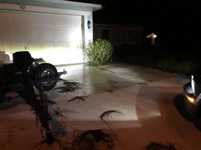

For all interested Im going to be reviewing a set of led fog light bulbs with my 02 gt when they arrive too. Im still waiting on another style of headlight leds to come in for my 07 gt but China is far lol. Im interested in how this will turn out. Stay tuned my peeps.
07gts197
Feb 5, 2015
1,171
124
Naples, Fl

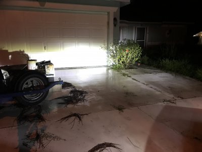

Alright so my h13 leds came in today. I was pleasantly surprised to see how well they were packaged. They look to be good quality so far. Anyway down to business.
So my thought process was that since this design does not have a shield and is two sided, as opposed to the leds I was running that are 3 sided, so they may have some glare but I figured they would have a little better beam pattern with this design.
After installing I realized the led was seperate from the locking ring allowing the led to be oriented in any direction. I initially oriented them vertically so there was one led on the right side and another on the left. This led to horrible glare and a terrible cutoff. So I moved them horizontally so there was one led pointed up and one pointed down. This yeilded better results with a nice cutoff but left a little bit of a hot spot but its hardly noticeable.
I took it out for a spin and noticed 2 things compared to the pair I have been running since the op; the light output isnt a great and the high beams arent much better than the low beams. I dont use my high beams so its not a big deal but it would be nice to have them lol. The light cutoff is sharper and there is a lot less scatter with this design but either they dont put out the same amount of light as the other design I tested or they cast light lower. With that said, these are more forgiving to oncoming drivers but they dont light up the road as well. Im going to put the other set back in and take pics from the drivers seat to compare to these.
For anyone that wants a step above stock headlights without being obnoxious or wants to use leds with projector headlight I would recommend these. If you want more light output and want to risk blinding oncoming drivers then get the first set of leds I reviewed. With that said, I have been running the first set I reviewed since then and have yet to be flashed but I can tell there is more light scatter than halogens so theyre probably borderline annoying to oncoming traffic. And as always pics will be uploaded below.
Thanks for reading, if you guys have any recommendations or comments please dont hesitate to post here!
