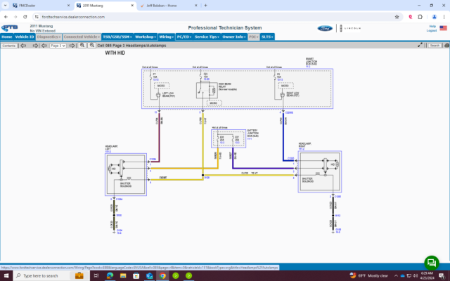

Take a look at your SJB if you see some signs of overload, like melted plastic. In the EU red blinkers are not allowed so the import companies connected all brake lights to the line of the 3rd brake light which leads to overload and a defect of the driver transistor in the SJB, but not immediately instead after 6 month of driving.
You should measure the voltage at the SJB to get some more information.
The driver transistors can be repaired with basic solder skills, it's not too difficult.

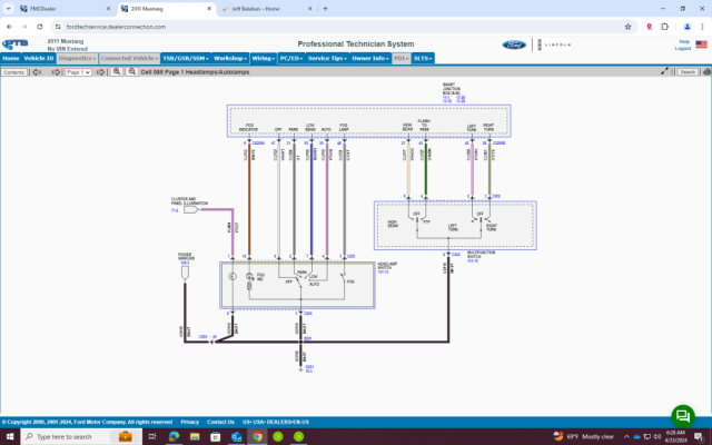

maybe the multifunction switch? They like to route everything through there it seems. Although they're on national backorder at the moment apparently, I've been looking for one myself.
