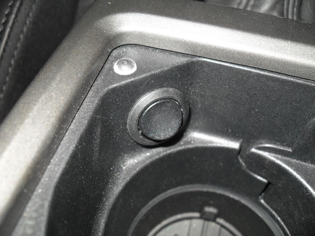

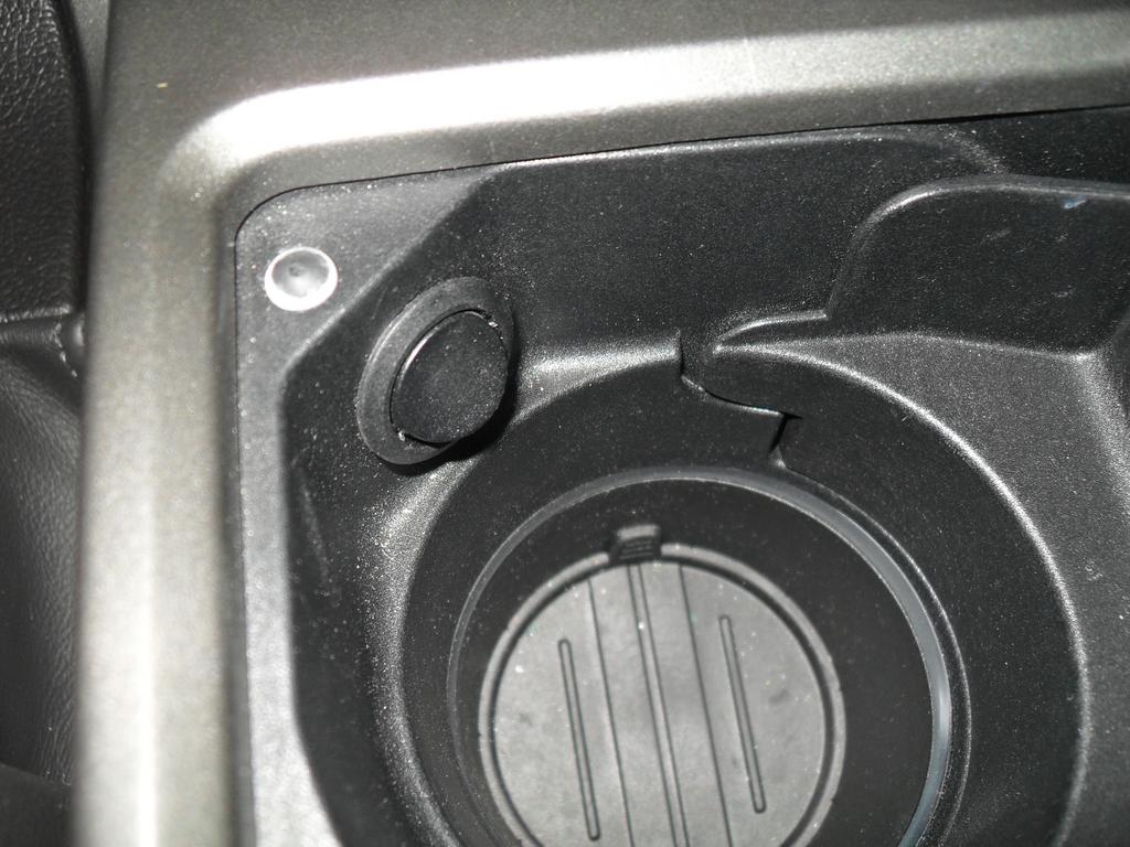

I did a two solenoid unit. Personal preference. It was the way I was taught before you could buy a kit. Install was simple and minimal bleeding of the brakes because you install them in the wheel wells. It also lets you upgrade the brake lines to braided if you haven't done that yet.
Driver's side. I think I drilled 1 hole to mount it right where the hard line from the booster connects with the stock flexible brake line. Then just attach the steel line to the caliper and bleed. I wired the button to my shifter handle.
