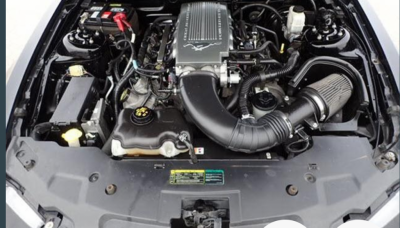

Just picked up a 2010 gt today. Its a 2 owner with 80k miles. One of the previous owners put on a roush cold air intake ( https://www.americanmuscle.com/roush-cai-2010gt.html?utm_content=Intake - CAI|Roush&utm_campaign=AMM 2005-2014 Years&utm_source=google-pla&utm_medium=shopping&T5_Var3=blue&T5_Var4=69057&intl=0 ) And the dealer didnt know anything about the mods done. Not sure if exhaust is stock but sounds really good. Had to drive an hour out of town both ways twice and was raining so just checked for rust/leaks/oil/ and test drove it.
Ended up with decent deal.....Just got it home.
They filled the tank up for me but im worried it may have a high octane tune and theres noway for me to know. Should I run premium untill I get a tuner?
This is my first mustang. Ive had several crown vics so have worked on the 2v 4.6's but this is my first 3v and Ive never tuned anything and havnt done any performance modding since I was a teen with old 60's impalas so the whole tuning thing is new to me and need to start doing alot of research.
Anyway....from my understanding , in 2010 they redesigned the CAI to net 15+ HP over previous 4.6s so wouldnt it be pointless to add an aftermarket CAI without a tune? Should I just treat it as having a tune and use premium gas untill I eventually get myself a handheld?
Im sure they put regular gas in it, Its hard not to go full throttle but refrained from flooring it thus far untill i use the tank of gas up and get premium gas.
Also ...filter looks pretty bad, need to check it out closer tomorrow. Is there a replacement filter to buy or I have to buy whole kit?
Any thoughts, points, suggestions?

Welcome and congrats on the new Pony! I looked at the ad for the CAI and it states that no tune is required. so that being said, I would "assume" that other than the CAI, the car is pretty much stock, which is really good. I would also "assume" the car still has the stock tune which is also very good. the 2010 is basically the newer body style wrapped around the 09' drivetrain in both V8 and V6 versions. having the stock tune on the car is imperative if you ever decide to put the car back to stock if you decide to sell in the future. not going to scare you but that's what most ppl do with these cars, so it may look stock but could have been beaten on for a while then put back to stock to sell. hard to tell the history of a car without knowing the previous owners and their story. you are also correct in that Ford redesigned the CAI for 2010 and getting the aftermarket one was kind of a waste. you can go the new route for parts if you want. if you want to save money and aren't in a hurry, keep an eye on your local CL. many Mustang forums/sites have a classified section so scour them as well. as far as the tuner goes, I would look for an SCT version, their latest being the X4 I believe, I have an older 3015/SF3 and it works just fine. they do come with canned tunes and will allow you to adjust some things like tire size, fan temp turn on, idle, rev limiter, etc. make sure if you purchase a used one that it is unlocked and has at least 1 pair/marry left. the actual tuning ranges from generic email tunes to high dollar dyno tunes. I have Brenspeed email tunes and have been running them for about 3 years now with no issues. there are multiple email tune developers out there. AM has Bama with tunes for life. I wouldn't use them if they were free. WAY too many issues with cars not running right, having to datalog and send in to tweak a tune. there are tons of ppl on these forums that come for help after using Bama. Lito, Steeda, Brenspeed are just a few. depending on your timeline, you could buy all the parts you want then get a tune for them so your not adding, flashing, adding, flashing over and over. every time you want to update a tune, you need to put the stock tune back on the car, download new emailed tune to the tuner, then go back to the car and upload/flash new tune to the car. I always get a bit nervous when I go to update my tuner and have to put the stock tune back on the car, I know in my mind its going to work just fine but ive read to many stories of ppl locking up their comp because they didn't wait long enough for the process to finish, battery was to low. there are some horror stories out there. if you have emissions testing in your area, I would shy away from headers, catless exhaust, OR midpipes etc. not really worth the headache and cost IMHO. I would say your good to run 87 or 91 octane with no issues and that's "assuming" your car is still stock. as stated above, you can get a new filter or just wash and re oil yours. sorry for the long rambling reply, just want to give you info. again Welcome and good luck!

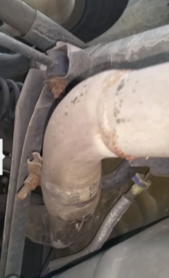

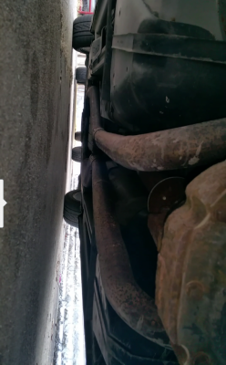

Finally no rain today and could get under the car. Has stock manifolds, cats / h pipe. Catbacks....not sure whats going on.... looks like they deleted mufflers and welded straight pipes in, axle back is kind of a cobbled mess.

Headers really woke my car up and if I could do it again, I would’ve a lot sooner. I had a O/R pipe for a couple years before my Longtubes, and after Longtubes, still with O/R pipe, the car wasn’t as loud on cold starts, which made me happier. It’s still loud, but doesn’t wake the zombies in the backyard of houses a block over anymore. Installed mine when I built the bottom end and had my motor bored so I can’t say for a direct HP difference. But if I could do it again, I would’ve done it a long time ago.
