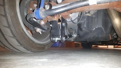

Hello everyone,
I recently had LCA and brackets installed. I haven't noticed this in any other pictures which is why I'm starting to question this. Is it normal for my LCAs to be angled like this?

are you talking about the way the heim joint is cocked to the right at the axle?

@Wes06, correct. Both of them were are aiming inwards.
