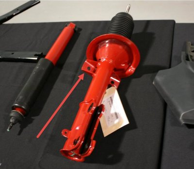

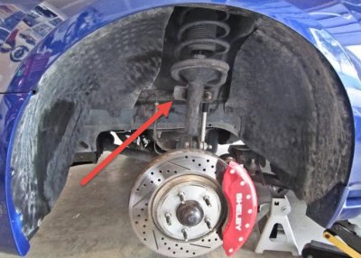

However, the stickers on the assemblies claim left and right parts...for the entire assemblies.
The stock struts only have one hole where the sway bar end links mount - that is what makes them side-specific. Most aftermarket struts have holes on each side, which allows you to mount a strut on either side of the car and still connect the end links.
