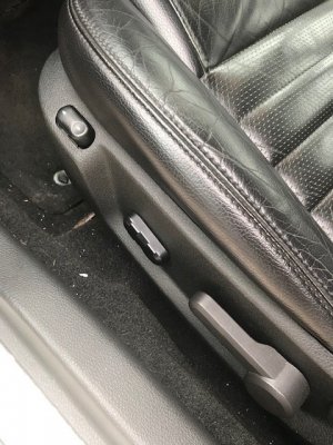

I have an 07 GT premium with leather seats. Is there a lumbar adjustment lever/button? I can't find one but I can't imagine a "premium" wouldn't have adjustable lumbar support?

if it has it, there's a rocker switch on the left side of the seat

Ahh, thank you. I do have the rocker switch, it just doesn't work! I've put about 2,000 miles on the car since owning it, and on a longer trip the other day, my back was killing me, but I didn't notice that switch, or didn't realize what it's supposed to do until now.
