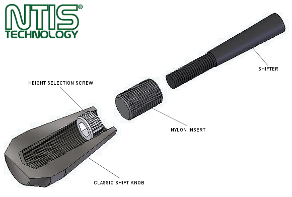

What's the difference in thread size &pitch between the shifter and the ball? You might be able to get an adapter like this:
or this
If there's no adapter right out of the box that'll work, you might also be able to drill/tap the threads on the ball to accommodate an adapter. Might be easier than having the shifter machined.
