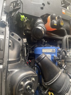

The MAF wire harness was the issue for me . I found it myself after a “performance” shop replaced something that didn’t need to be replaced .They were idiots so I went and got my car back and did it myself . For mine it was the plug on the MAF harness that connects to the large 14290 harness . It had obviously been arcing and throwing things off there are 6 different wires in that connector so it was more than the MAF that it could cause issues for.
When I disconnected the plug it broke off inside so the shop obviously hadn’t even bothered to check it . I have also seen others post in forums talking about the same situations. In the picture I had pulled the CAI and flagged the plug on the 14290 that it melted in with a green twist wire. Hopefully this can help someone .
