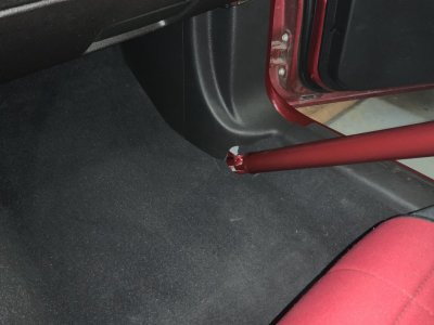

Just a couple things for fun. Not mentioned in the instructions is the passenger side kick panel needing to be trimmed to clear the door bar mount. You have to be able to put the bolt in the hole.

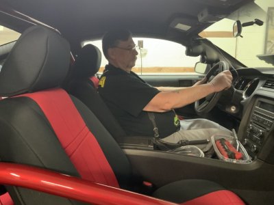

How the heck is anybody supposed to get into the rear seats ??

And this guy fills it right up. Cheers!......
It does look a little cramped. Ask "This Guy" where he puts his left arm if he does not have it on the steering wheel? Can you just put your arm on the bar and it is comfortable?
Can you pass tech with stock seats? Don't they have to be attached to the harness bar?
Thanks again for this build thread.

This guy won’t be taking his left hand off the steering wheel when the door bar is in place. Even with a little padding I don’t see that bar being comfortable for more than a short ride. As far as passing tech, I believe the rules say the seat must be attached to the cage with at least one bolt. This is not a cage. With stock floor pans I should be good for something like 10 flat or 135 mph.
