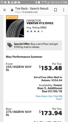

Here is what I found on tire rack in your siZes

They are staggered SVE wheels, 9 in the front and 10 in the rear. I am thinking of going with the hankooks because of price but I would prefer all seasons.
