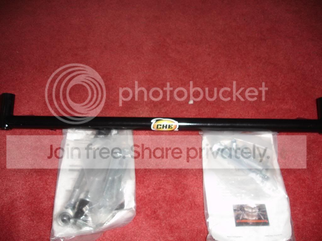

Transmission
-CHE K-Member Brace with torque limiter

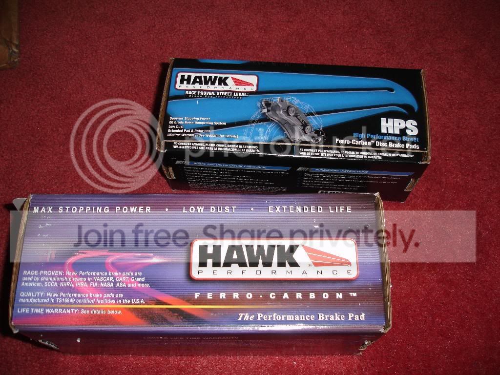

Brakes
-BAER Decelerator rotors for all four wheels
-HAWK HPS Pads

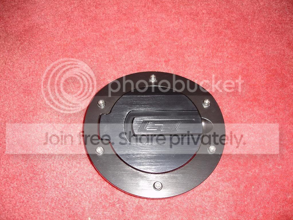

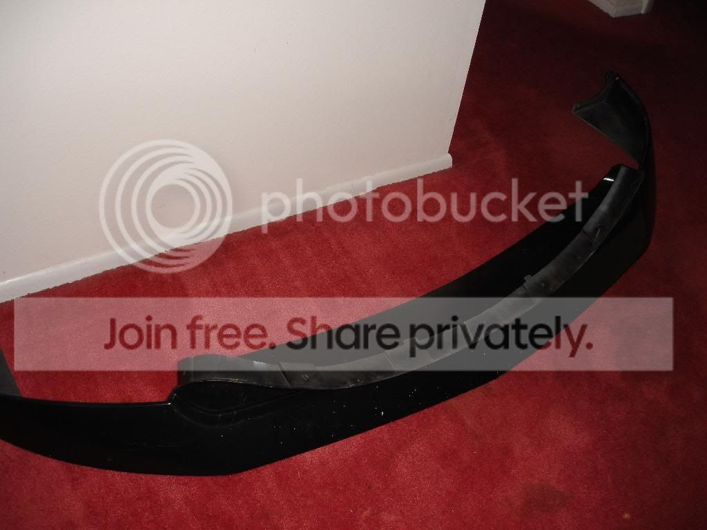

Looks
-SHR Black Fuel Door
-Black Upper/Lower Billet Grille (Pony Delete)
-1969 Grille Emlbem (Not Remake)
-CDC Aggressive Chin
-Open headlight bucket mod

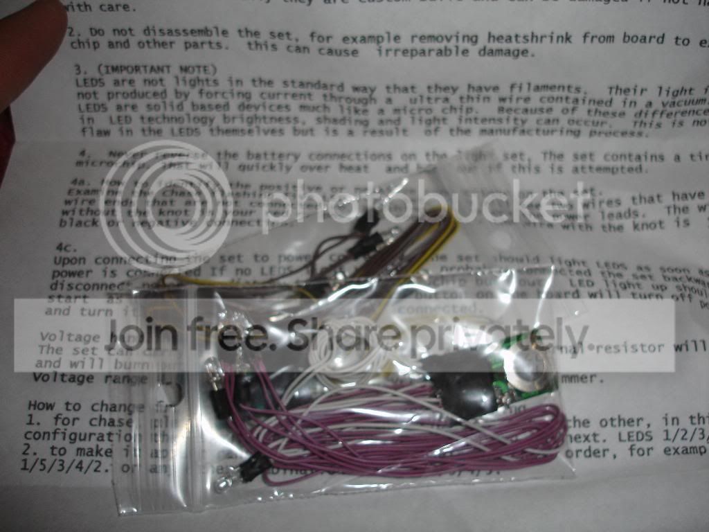

Interior
-White face gauge overlay
-MyColor Cluster
-LED's for interior color change

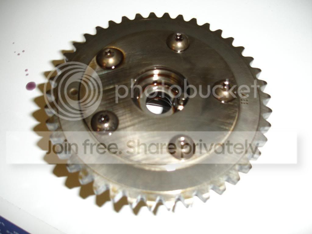

So yesterday I spent the day taking a lot of stuff apart. There was a problem with the original blower I bought so I had to wait to find another. JDM has sense shipped out the new blower and should be here in the next week. So in the mean time I prepped everything and did other things that would be needed.
I started the day off by removing the CDC Shaker and CAI. I had presold those items and the buyer was coming by to get them. Once that business was taken care of I then made the goal to get the CAMS and phase limiters installed.
Everything went pretty straight forward and was not as hard as expected. Just take your time if you have never done it before and it will all make sense once you get in there.

I tried to use the compressor tool but it wouldn't compress the springs far enough and I got mad so I didn't use it. I just back the bearing caps off slowly like half the other guys.
Bearing caps off.
Phaser and Sprocket removed awaiting the COMP Phase limiters.
