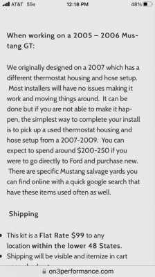

According to On3 I need to get a 07-09 thermostat housing and “hose setup” to make the turbo fit. I went to order it and quickly got confused. Is it just one hose? Which one/ones? I dunno my way around my 06 or the 07-09’s so I don’t want to order the wrong stuff. Is there a kit or something I can get?

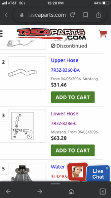

Is it this whole assembly? It just says “lower hose”. Do I need the upper hose?

My hose setup looks like the one in the pic. I noticed Tasca website say “from 06/05/2006” but I put an 07 in my search. Is it possible my car was built after mid 2006 and I already have the 07+ setup? On the SN95’s Ford changed the water pump shaft mid year…wondering if it’s something similar here

You only need these two hoses (upper & lower radiator) to go with the '07-'10 coolant crossover/water neck (part no. 7R3E-8C369 superceded by 7R3Z-8C368-D):
https://lmr.com/item/LRS-6608K/mustang-raditor-hose-kit-gt-bullitt-08-10
crossover-jpg.71575
You'll also need a new thermostat, thermostat housing O-ring, and the two gaskets for the coolant crossover. You can order all of those parts from rockauto.com

Ok awesome…thanks! I didn’t know I needed the crossover housing! I’d have been out there for months trying to figure out how it all hooks back up
