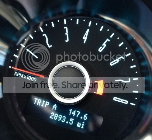

Reset trip after filling up with fuel (93 octane)..

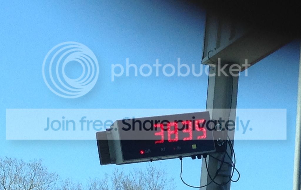

After signing in with tech I weighed the car with me in it, I'm about 165-170 pounds..

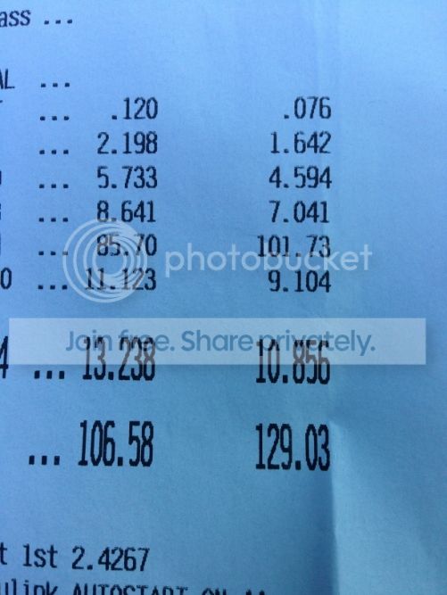

On the first pass the car spun on the hit, so I allowed some cool down and came back with a pretty good burnout and here's the result..

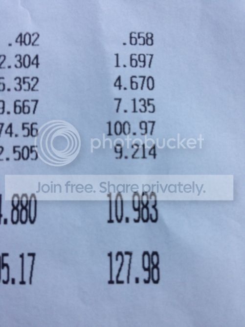

After some more cool down I tried again..
I tried one more pass and it spun so I called it a day. This was a TnT day and the prep is not typically that great and also there was alot of street cars on street tires driving thru the water and diesel trucks hot lapping. Overall I'm pleased with the ET and mph considering the 60's and conditions. It's pretty cool to drive 140+ miles to the track, drop air pressure, run 10's, air tires back up, and then drive home LoL.

Sweet numbers! What boost you running out of the GEN 2? I am running a Gen 1, with about 9 psi, to get similar numbers. I do not have Long tubes or the drive shaft. My best mph was 127 on my last outing. You went 129. Whats interesting is we both went 101.x in the 1/8 with almost identical ET. Did your car shift into 4th? Maybe the Gen 2 shines on the big end, when charge air temps go up? I have been wanting to weigh mine, I'm guessing, I am right there with you weight wise.

I'm running the 85mm pulley and for the majority of the pull it was 8 pounds but did peak at the very end at 9.2. My car went to 4th near the end of the 1/4. What's killing me right now is the 60', the temps were pretty cool and I had brand new tires so I assume that's the issue or my suspension may need some fine tuning. Based on the mph and 60' I'm pretty confident the car could go low 10.7s or maybe a high 10.6 as is with a mid 1.5 60'. I may try again to see what happens but to be honest I'm pretty pleased with the current et when you consider the entire timeslip.

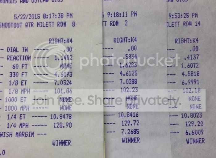

Thanks guys, I'm very pleased with it! The previous best was 10.85 in negative da, last night it went faster in roughly +1800 da. That's a good sign for fall weather lol.

Went back to the track today for a true street race, the only difference was I added better fuel and a tune for it. DA was +2700
