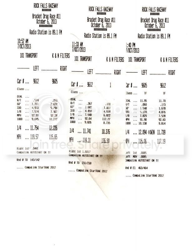

+1100 to +1300' DA throughout the day. Car has a Boss IM, Pypes offroad x-pipe, JBA mufflers, Airaid CAI, Circle D 5C, and a tune from Mike Rousch at Mid Atlantic Performance. Stock 3.15s, driveshaft, and exhaust manifolds. Front sway bar disconnected, otherwise stock suspension with SR lowering springs. Old worn out M/T 255/50-16 drag radials. 1/2 tank of gas and no weight reduction other than the spare tire.
My best 3 runs from the day are shown below. Car #9612. Previous best with stock converter was a 12.06 at 119, 1.93 60 foot.
I was hoping for a slightly better 60-foot and maybe 11.50s-60s but I think it will come. It's certainly a whole different animal with the converter. Really could use more tire now.
I am going to another track this coming Saturday to try again.

What track are you running at? In your area I would have thought the DA to be 3,000+

I think you definitely have more ET left in it with basically 120 mph trap speed. Get that 60' in the high 1.5Xs and you will be in 11.30-11.40 territory.

Nice progress. Compared you splits with some other cars I already have the numbers on and nothing looks out of line anywhere down the 1/4, so the 60' does look like the best place to gain ET right now. Agree with your thoughts on more/better tire. I do wonder how it might respond to the stock intake manifold instead of the Boss.

Nice times!
The person you raced in the 3rd time slip really took as little stripe as possible! They almost gave it back to you lol
