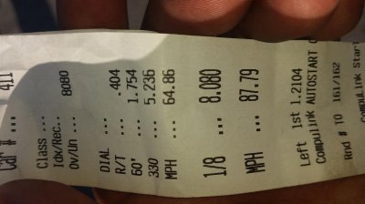

Posting this up for some in site, I feel like this car could be in the 7's or should have already been. I installed UMI non adjustable LCA and a double adjustable upper control arm and received a bunch of popping, thought it was the drive shaft.
I installed the Rear diff bushing from BMR and rear is now solid.
Only track open so I am limited to the 1/8th and only got one pass in. Place was packed.

Thanks again for all of the help. I feel like my 330 was a bit slow as well.

After reading my original post, it is a bit confusing. I'm hoping for as much help as possible to get this thing in the mid 7's.
I feel like my car is under powered for some reason.

You're in the general ballpark, depending on the DA.
My car with similar mods ran this- (I had an offroad x-pipe, but the stock 3.31 gears and 18" street tires)
Usually, a tenth quicker at the 60 would equal a tenth quicker at the 1/8th. So in theory, my pass would've been a 7.77 @ 91 if I was on your slicks.
