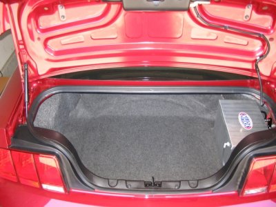

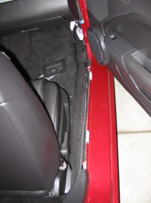

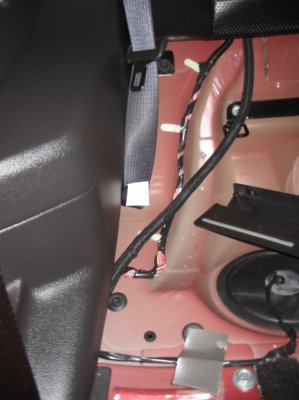

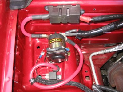

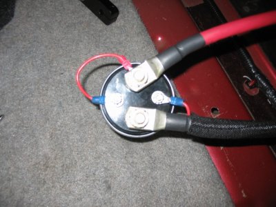

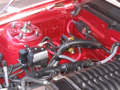

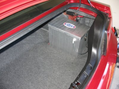

Frustrated by my lack of traction, I decided to relocate the battery to the trunk to help with weight distribution. The arrangement shown in the schematic guarantees that both the battery and the alternator will be isolated from the engine (and each other) if the rod is pushed in. In addition, only one heavy gauge wire is needed from the trunk to the engine compartment. I did not want to have to run two thick wires, and have the alternator current travel a distance of 30 feet before reaching the loads. I've got two electric water pumps which draw a good bit of current continuously, and I want the alternator to be very close to these loads. I also like to rock while I'm spanking Camaros
, so the closer the alternator to the electrical loads, the better.
This arrangement will not draw any current when the key is off. So the battery will not drain when you walk away from your car. The only time the relay and solenoid are drawing current is when the master cutoff is enabled, and the key is on. The penalty for these features is an additional automotive relay ($6 at any automotive parts store) and a high current solenoid switch ($75 from Summit - still searching for alternatives). I think this is a reasonable price to pay to have an NHRA legal system which does not draw any current when shut down, and requires only 1 heavy wire.
I was conflicted on whether to keep the "push off" rod in place all the time (cool - a serious drag car!), or keep the car looking stock and beautiful without any blemishes. My vanity won out, and I plan to keep the stock tail light in place for daily driving. I got a cheap replacement light off ebay which is drilled for the push off rod. It takes only 15 minutes to hook up the push off rod and special tail light.
The car runs great as usual after this mod. It starts just fine - no indication of weak starting. The charging voltage is around 14 volts, just as it was before the modification. I still plan to go and measure voltage drops everywhere for reference.

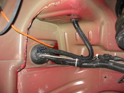

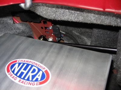

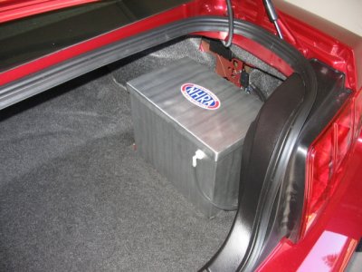

A few final photos. I would like to do a little more work on the trunk carpeting, to hide some of the wiring. Also, I still need the required "push off" lettering near the push rod. I'll probably use Photoshop to make a decal.

Yes, I mentioned in my first post that I'm only activating the alternator solenoid (Painless constant duty) when the key is on. So this prevents the battery from draining when the car is off (see the schematic). I may also bypass this solenoid for daily driving use, as it gets quite hot. But I figured I'd drive around with it activated for a while and see whether it fails in the next few (summer) months or so. At least I have enough fuses so that I don't have to worry about an electrical fire!:thumb:

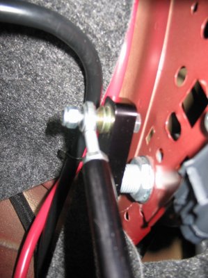

Bringing this back from the dead as I need to do this now that I have a car with the battery in the trunk.
Everything is already relocated, but the previous owner didnt install a cutoff switch. He wasnt concerned with making it NHRA legal. I am, as HRP in Houston will probably be a stickler about this.
Red, did you have to weld anything into the trunk to mount the bracket for the switch? Can you give me a picture that shows a better angle of how it's mounted?
I can this evening. I used this same setup. I drilled the panel behind the carpet on the drivers side.

Thanks for those pics. That makes things clearer for me.
