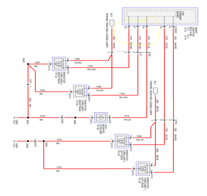

My third brake light works but others two don't tail lights turn signals hazards everything else work fuse is good brake light should be good if third brake light works replaced turn signal switch but still nothing

What year? GT or Base? Most likely the brake light switch.

It's a 2006 gt there is power at the brake light fuse and power at the brake light switch even if I jump the switch only the third brake light works

Look at the above wiring diagram that was posted by another member. Verify power on all wires coming off switch. The brake Lights and the 3rd brake light have separate wiring.

I'll have to check when I get off work today is that the plug on the outside of the sjb that you can see same side as the fuses
