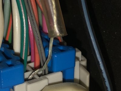

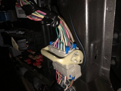

However, when doing a visual inspection I did notice (attached picture) that whatever this wire is, it looks to be slightly corroded. No idea why it’s done this way and exposed but that is the only thing I noticed to be a little weird.

Also that big locking clip ill call it, I had released so the wire could be seen better. This was done after the testing, I didn't want to possibly cause false issues before testing. I put it back into the original position after I was done taking the picture.

BTW....the exposed wiring that you noted running thru the connector by the SJB is a shield wire (a type of resistor) & is not to be concerned over at this time. Also fuses #4, #8, #10, #15 in the SJB are supposed to be hot at all times so a non issue.

That wire in your photo is not corroded. That is a common ground or a shield for a sensitive circuit. It is fine.
