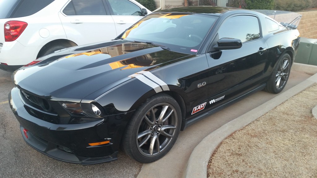

So the Mustang is almost ready to go for the year, just adjustments to go now. Get the Watt's dialed in, change rear alignment a tad, re-do toe and get the front wheel fitment just right...little stuff like that. I still need to do something about my illegal FLCA's and the squash bushings they currently have...so that's still on the list.

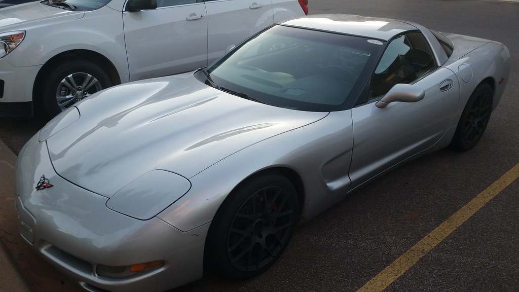

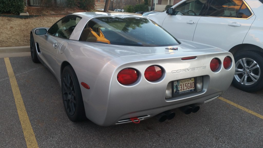

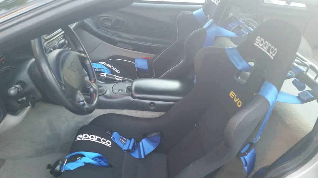

Also, there's a new addition to the family. 2002 Z51. Has some nice mods...headers, exhaust, intake, Sparcos, cam, twin-disc Centerforce clutch, Schroth harnesses...etc. Only plans for the time being are to get the shocks sorted out (Bilstein ASN's???) and some really big Forgestars. Can't put a Vorshlag sticker on it without really big forgestars.
It might become a TT2 build...we'll have to see. I'd have to get it to max power/weight and figure out some cool aero. Been looking at C5R pictures. Anyway, here it is.

Congratulations on getting getting your strut shaft and YOUR New Purchase (The right color too). I’ve been off this forum for a while. I looked for a C-5 platform in the same color for over a year but couldn’t find one that thought was a good enough deal for a complete tear down and ended up with something I never thought I would buy again – It just fell into my lap (94GT Mustang never registered for the street) - An old TTS car that I am hopping to get track ready again by mid April. Something a bit safer so I may develop my driving skills further.
Again – Great purchase for TT2. Bury the flip up front lights and put in some fixed ones if even needed – Several people have kits - 12 LBs + minimum weight savings off the front end. Better aero at night and you will have already taken the points hit with any type of other added aero. NICE PURCHASE
