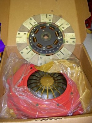

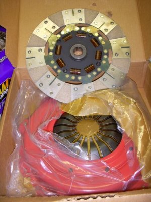

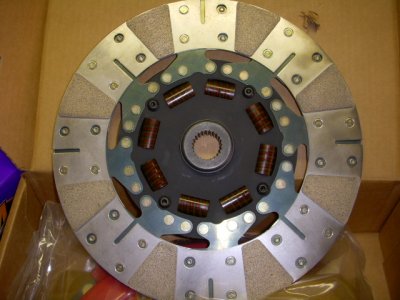

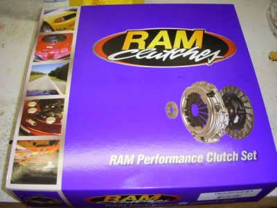

I have one of these replacement clutches here in stock. If any of you guys can't get your dealer to locate one, I have one available.

Part number: BR3Z-7B546-AD
This is sold now. A dealer from NY got it. As of this morning, according to the locator, this was the only one nation wide. I hope you other guys are getting taken care of.
